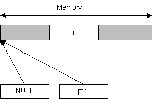

In real life the null pointer is usually the very bottom of memory. In the diagram on the right you can see that ptr1 and NULL point at the same location, so you can regard ptr1 as a null pointer.

here, ptr1 is acting as a null pointer
